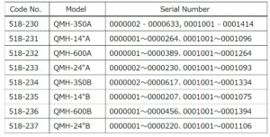

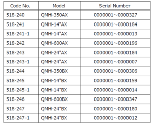

2. Model: QM-Height series, total of 20 models
a. Manufacturing timeframe: April 2014 – January 2019
b. Manufacturing timeframe: February 2019 – June 2021
