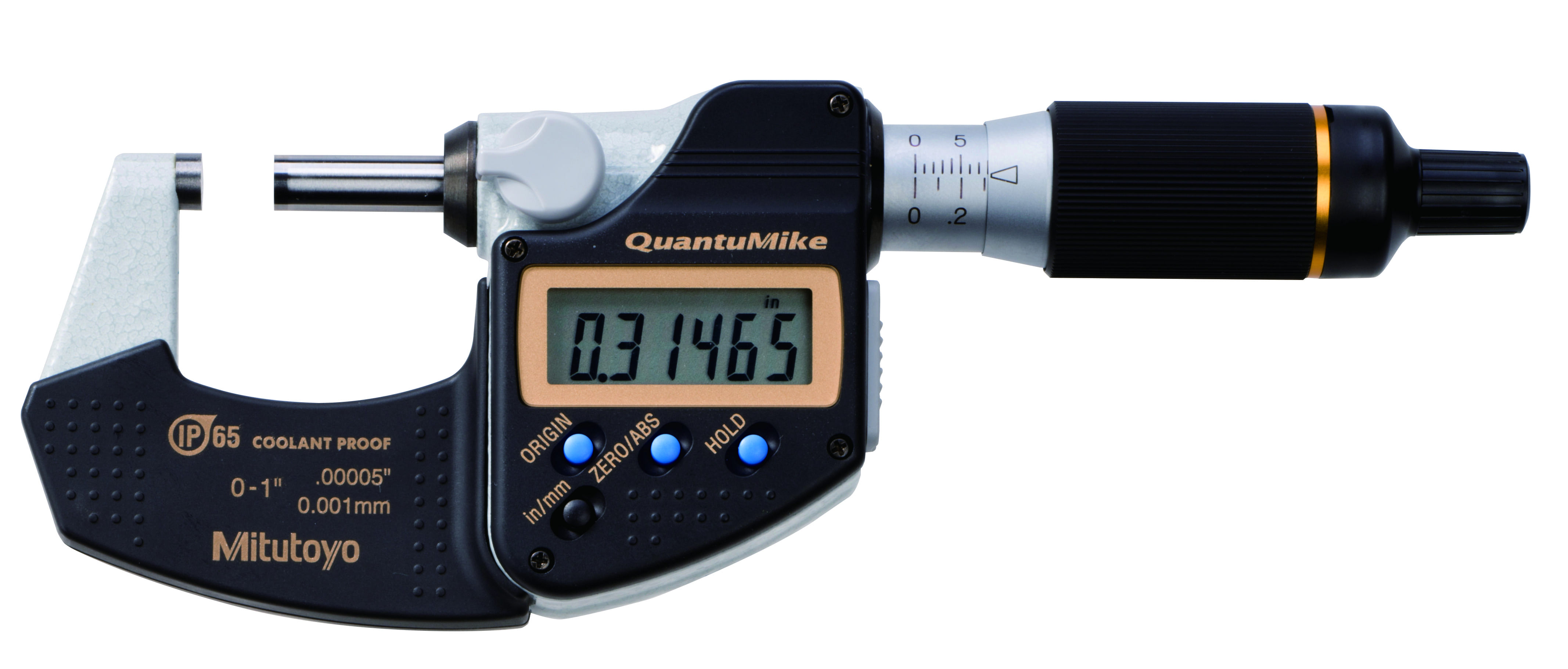

QuantuMike Series 293-Coolant Proof Micrometer
  • Up to 4X faster spindle feed over standard micrometers. 2mm per thimble-revolution as compared to the standard 0.5mm.
  • An additional comparison to conventional micrometers, QuantuMike’s spindle positioning time is reduced by about 60 percent while overall measurement time is decreased by as much as 35 percent.
  • QuantuMike provides accuracy at an industry-leading ±1μm/.00005” throughout its measuring range.
  • Rated a high IP65, the QuantuMike Series is totally protected from dust and protected against low pressure liquid or coolant
  • Available with SPC Output.

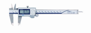

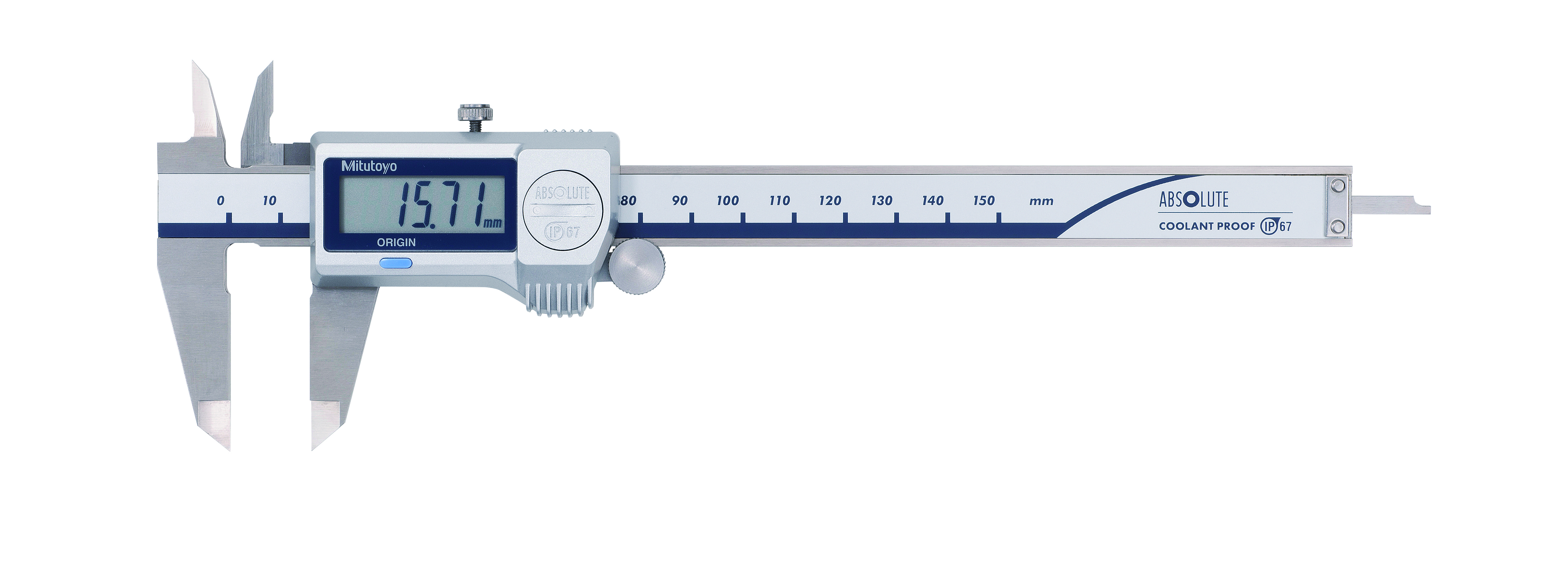

IP67 ABSOLUTE Digimatic Coolant-proof Calipers
  • Calipers rated a high IP67, total protecting the tool from dust and if immersed in liquid or coolant for a short period, will still work at 100 percent measuring accuracy.
  • A Larger LCD of 9 mm, a 22 percent increase in height for improved visibility.
  • The automatic power on/off shuts down the LCD after 20 minutes of inactivity, but the ABS scale origin is unaffected. Power is restored to the display when the slider is moved.
