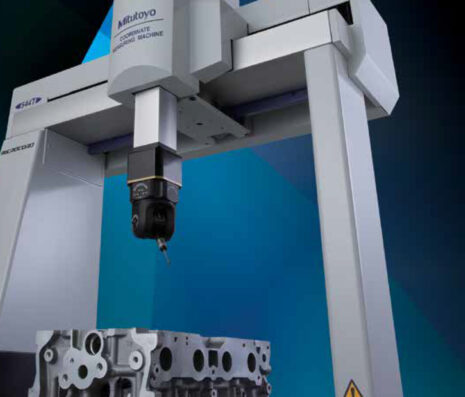

Because some transmission cases Dynamic Manufacturing works with are very large, the 9108 size Mitutoyo CRYSTA-Apex CMM (900 x 1,000 x 800 mm measuring envelope, which is approximately 35 x 39 x 38 inches) was recommended to provide additional Z height. The CMM also incorporates the Mitutoyo Surftest probe to assist with measuring.
Prior to implementation of the Mitutoyo CRYSTA-Apex CMM, Dynamic Manufacturing used a manual CMM without a motorized indexing head. To check certain specifications took 30 to 40 minutes. Now, inspection time is approximately five minutes, with dimensions and surface testing done in a single operation.
