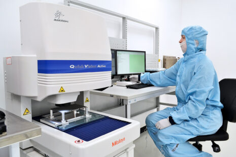

“Having considered and dismissed several other metrology manufacturers’ options, we took samples of our new high-power module to Mitutoyo’s demonstration facility. The samples were placed on the bed of a Mitutoyo Quick Vision Active, CNC vision measuring system. The Mitutoyo device quickly performed a complex measuring procedure and generated a very accurate, graphic, onscreen 30 map showing both the accurate topography and the precise dimensions that we required. Subsequent measuring routines confirmed the impressive accuracy and repeatability of the achieved results and gave us the confidence to place an order.”
“After attending an informative two-day training course and following the trouble-free installation and in-house calibration of our new Mitutoyo CNC vision measuring system, our operators soon became skilled in its use. We are now making the required in-coming and post process, precise quality control checks on our new high-power module and achieving excellent results.”
“Given the high volumes of products we will be measuring when full production commences, we have had robust fixtures manufactured to hold the high-power modules securely in place whilst they are being measured. These fixtures will also allow quick loading and unloading on to the Quick Vision Active machine. We have also written several measurement programs that allow fast accurate, fully automatic CNC measurement routines to be performed. This detailed preparatory work will prove invaluable when we are in full production.”

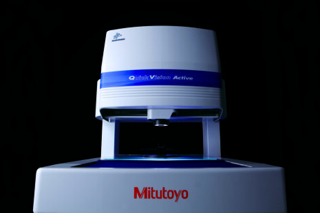

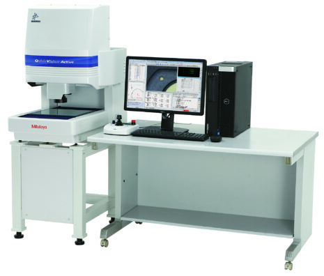

Based on a compact design, Mitutoyo’s Quick Vision Active, as purchased by IXYS UK Westcode Ltd, is an advanced, easy to operate CNC vision measuring system that combines the flexibility of a high quality zoom lens with the speed of a state-of-the-art digital color camera. Quick Vision Active provides a long list of advanced features, including programmable LED stage and coaxial lighting, a programmable 4-quadrant LED ring light, a high-resolution and high-speed CMOS color camera and high-quality 7-step zoom optics with interchangeable lenses.
Mitutoyo’s Quick Vision 3D CNC vision measuring systems are supplied as standard with the latest version Windows 10 QVPak v13, user-friendly measuring software. The ‘smart’ software controls all relevant processes, such as light control, magnification and part programming.
