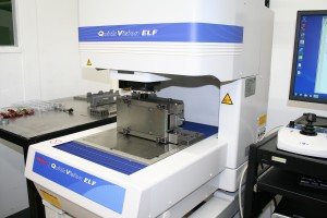

Joe Gallo, Ramcel’s director of quality, explained, “The bracket fixture was designed with ports to provide access to features requiring measurement. We supplied Mitutoyo with a prototype fixture together with sample prototype parts and asked for a measurement plan.”
Within weeks, at the Mitutoyo M3 Solution Center in Aurora, IL, Mitutoyo demonstrated a turnkey solution based on use of a Mitutoyo Quick Vision® Elf measuring system.
The Mitutoyo Quick Vision Elf is a compact (footprint 57-inch H x 22.7-inch W x 39.1-inch D) full-featured CNC vision system that is priced mid-level relative to Ramcel’s budget.
The benefits of vision vs. contact measurement were obvious: Introducing a contact-probe head through the fixture’s ports then moving a stylus inside the fixture would be problematic, at best. On the other hand, the QV Elf’s advanced, programmable, long-life LED lighting (including coaxial/stage lighting as well as ring lighting) and highly responsive focusing system would facilitate “seeing” through the fixture’s ports; the system would quickly obtain detailed, accurate images for processing.

Ramcel currently measures 150 features on the fixtured bracket, with each measurement cycle taking about 4-5 minutes. Gallo concluded, “The measurements we’re obtaining through this metrology regimen give me peace of mind knowing, that in terms of dimensional metrology, we are applying the latest, most effective techniques to help provide maximum value to our customer.”
