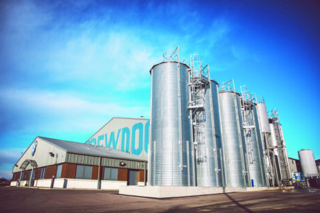

One such demanding purchaser of stainless steel brewing plant is Brewdog. Located on a 5.5 acre site in Ellon, North of Aberdeen, the Brewdog plant is a state-of-the-art eco brewery and is one of the most technologically advanced and environmentally friendly breweries in the world.

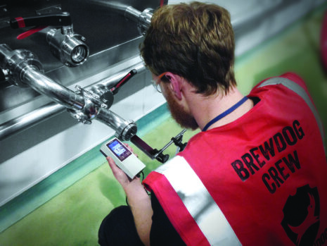

“As Brewdog is constantly increasing our capacity we regularly source new processing equipment. To help prevent hygiene problems – all stainless steel vessels, fabricated pipework and equipment we purchase has its surface finish check to ensure it conforms to our stated hygiene standards.“
“As our previously used surface finish checking methods were somewhat subjective and could lead to differences of opinion with our suppliers, we recently searched for a more objective means of measuring this important parameter. Having considered several options we purchased an accurate Surftest SJ-210, Portable Surface Roughness Tester from Mitutoyo. As our new surface tester is calibrated and its results are traceable to national standards, our suppliers see its findings as being unbiased and factual.”
“Now, in addition to using the new Mitutoyo instrument throughout our brewing plant, its light weight and portability allows us to bring it to our fabrication suppliers and to check that all stainless steels fabrications conform to our specifications. In addition to setting the instrument to a nominal surface finish figure of, for instance 0.8 μm Ra, we also apply acceptable upper and lower tolerance limits. This ensures that pass/fail results are displayed immediately after completion of a measuring routine. As we use the Surftest SJ-210 in some difficult to access areas it helps that its results are displayed on an easy to read back-lit LCD.”
“As well as improving our accuracy capability in this critical area, our new Mitutoyo instrument has also increased our speed of stainless steel surface inspection.”
