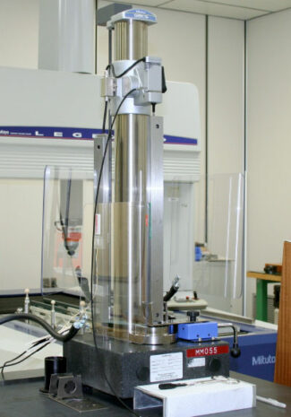

The Mitutoyo America Calibration Lab uses reference masters that are directly traceable to NIST (National Institute of Technology and Standards).  To achieve high accuracies and low measurement uncertainty levels, the lab calibrates all instrumentation in a Class 10,000 certified clean room environment.  When calibrating long gage blocks, temperatures are kept at 20º C ± 0.25º with relative humidity controlled between 40% and 60%.  Access to the clean room is controlled by a positive pressure airlock to prevent entrance of outside air.
Laboratory Best Practice procedures for measuring long gage blocks also include:
  • Verification of “single-point temperature stability” of the measuring station whereby temperature variation is verified to be less than 1/10 degree C per hour.
  • Real-time monitoring to make sure temperature gradients in the vicinity of the workstation remain consistent for the entire eight hours or more required to calibrate eight-piece long gage block sets.
