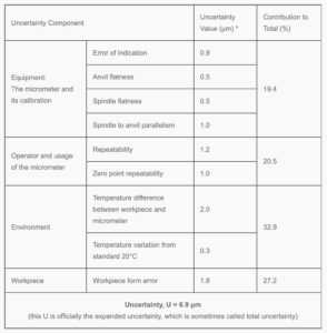

This question is best answered in a training class. However, we thought an example would be useful to see typical sources of uncertainty and how they add up. The table below represents an uncertainty estimate (or budget) for the measurement of a diameter using a 0-25 mm external micrometer. The values are for a specific measurement process and should not be generally applied to other measurements. This table is based on an example found in the international standard, ISO/TS 14253-2:1999. Note how the instrument, operator, environment, and measured workpiece all contribute significantly, and somewhat equally, to the total uncertainty. The uncertainty due to the micrometer is only a portion of the total measurement process uncertainty.
How to calculate measurement uncertainty
How to calculate uncertainty measurements
* These values, called standard uncertainties, are estimated for this specific measurement example. Do not apply them generally. They must be determined on a case by case basis.
